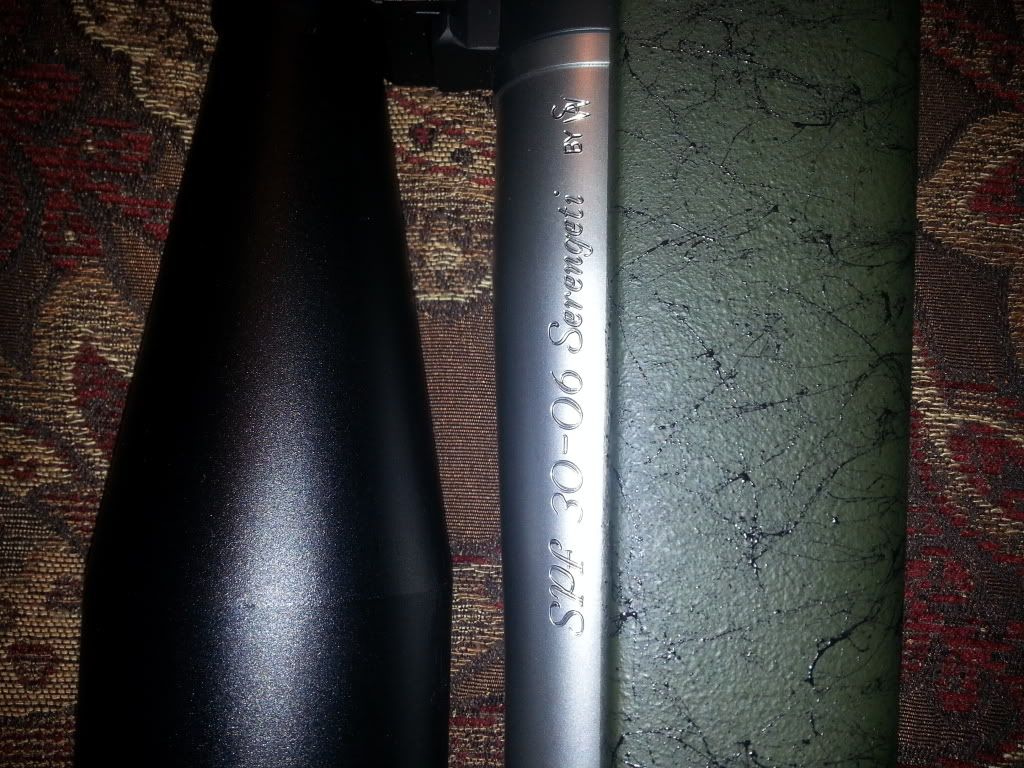

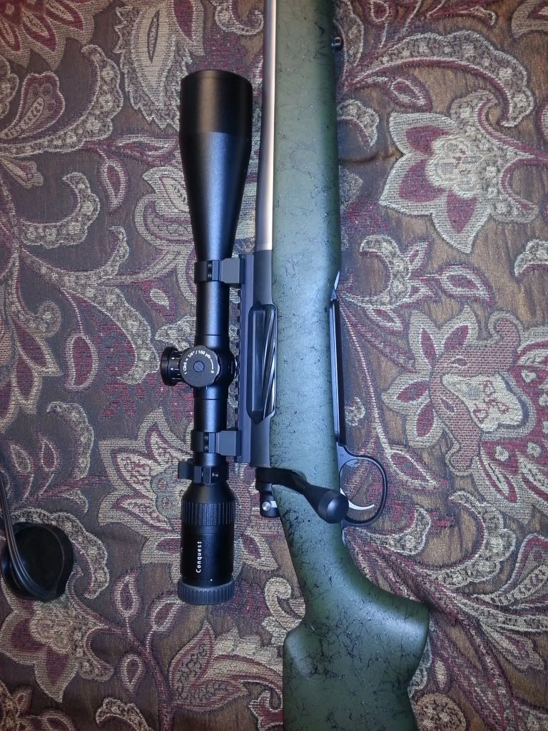

I have a new 30-06 barreled action I had built by Stiller Precision. The barrel is Krieger 10 twist 5R. I was reading about barrel break-in on Krieger's site, which says the object of the game is to smooth out reamer marks in the throat without allowing copper fouling to build up in the barrel. I was thinking about using cfe223 with a 150gr

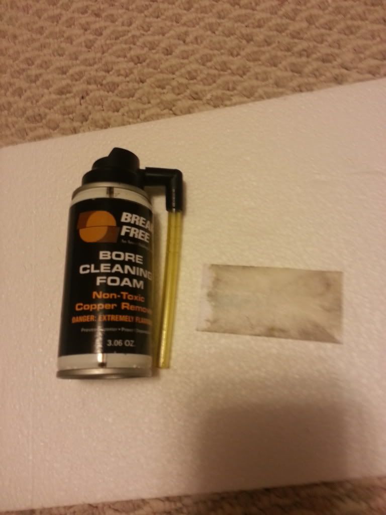

Decided to try some cfe223 and see what happened. Loaded 20 rounds with a 150 gameking and cfe 223. Also had 25 rounds with 200 gameking and H4831sc. I fired the 20 rounds with cfe 223 first and then shot a group with 3 rounds of the 200 grain load. I did not clean the rifle at all for these 23 rounds. Below is a 12 shot group with the last of the cfe223 loads at 200 yards. The next picture shows the first patch through the barrel after soaking the barrel for 20 min with the foaming copper remover. It appears that there was very little copper deposited in the barrel.

It doesn't sound right does it. It did however appear that cfe 223 kept the copper fouling at bay. if that is the case then maybe the throat can smoothed up without all of the cleaning.
