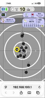

Drove up to the range to meet a few other guys to practice for the upcoming Sunday F Class competition. I am fireforming Lapua brass, from 6 BR virgin to 6 BRA. It's actually from a 30 degree shoulder ( BR ) to 40 degrees ( BR Ackley ) like a Dasher. Shooting them at 28.6 grains / 103 Vapor Trails, which is a very low charge at 2710 fps average with a SD of 3.4 which isn't bad. I have those bullets jammed .015" to keep the case head tight to the boltface for a good fireform. Just # 4 and 8 rounds went a little under the X ring whilst the remaining 8 was in a nice cluster in the X ring. Disregard the sighters. 80 more pieces to fireform and the tuning begins. 70 of those 80 will be used on Sunday.

I am pretty sure the BRA has potential by looking at the target. Until next time,,,,
