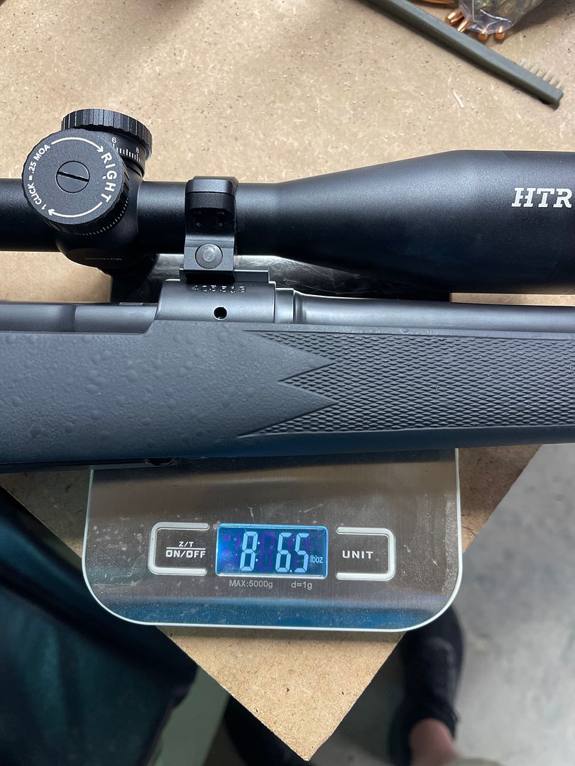

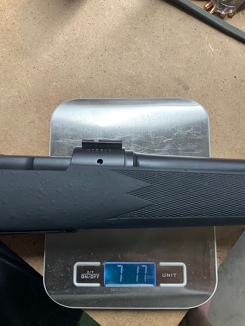

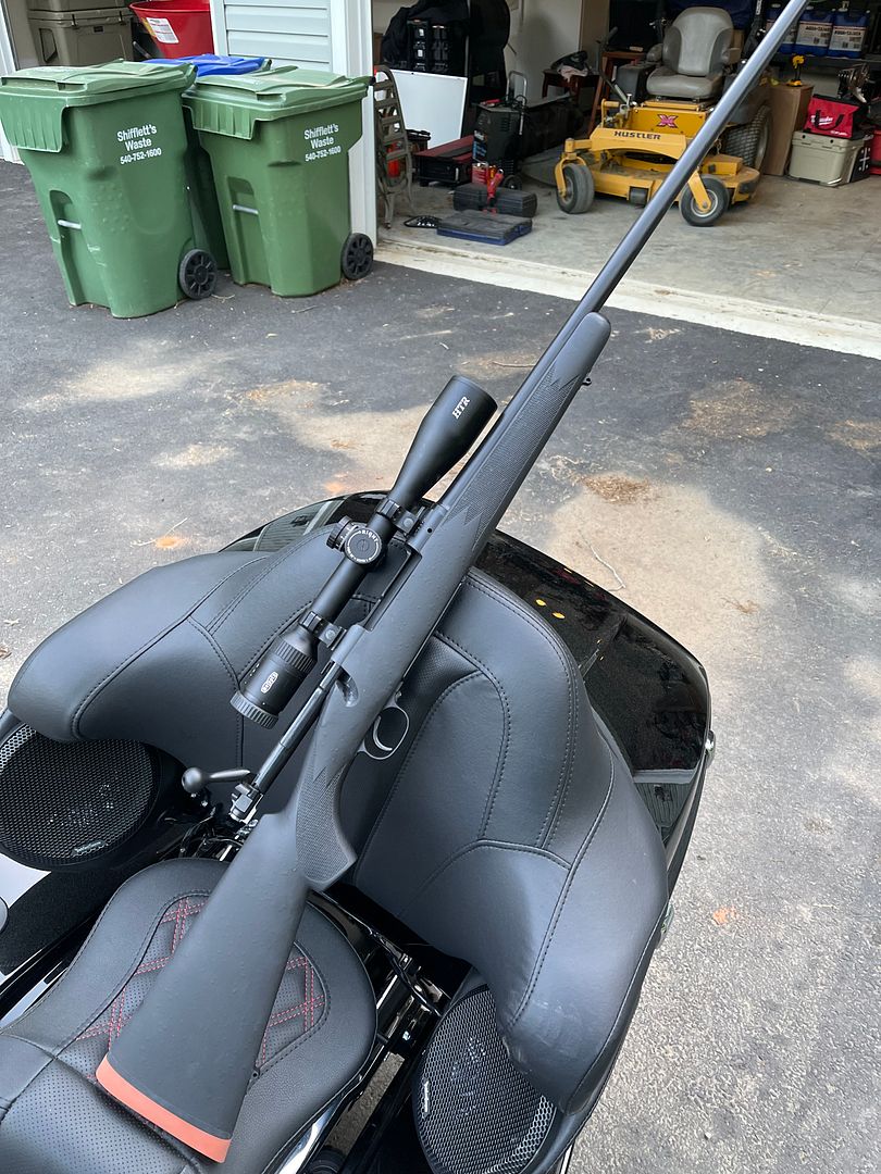

I have had a 7 Mash since about 2015 now. It’s been a great cartridge for me. The first was a rechambered old 70, then I had one built. As most of us who have had rifles built, the first time, it was a little heavy. I also didn’t spec the throating on my custom and it had a mile of throat. Made getting near the lands with any bullet nonexistent. So, I set it back to Kevin Weaver, had him knock the shank off, turn it down to about .6 on the muzzle and put it into a Hunters EDGE McMillan. I also traded the Blackburn bottom metal for Winchester Featherweight metal.

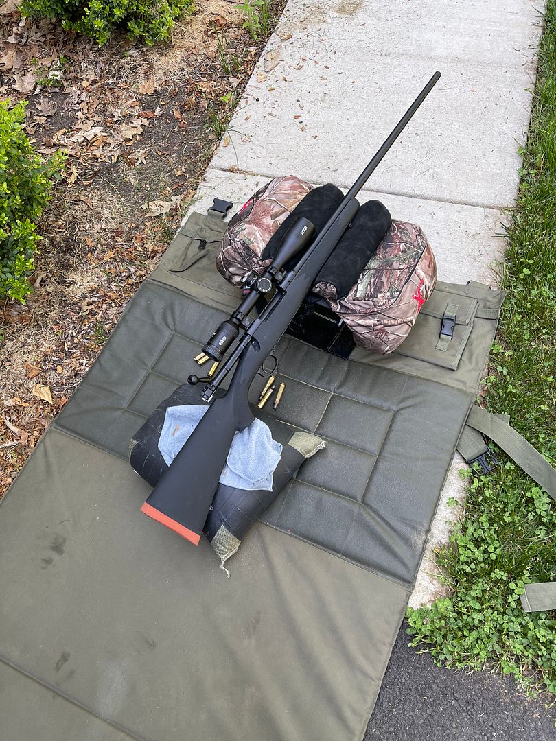

Got it down to about 7lbs bare. My goal is to have it scoped and such around 8lbs with a NF 2.5x10 or a 3x9 SS. Well, I didn’t have any 30mm rings so I grabbed a Meopta 4-14 I had at the house and fitted it up, till the rings come in.
Just a tic over 8 1/4 scoped. I was pretty happy with how it felt.

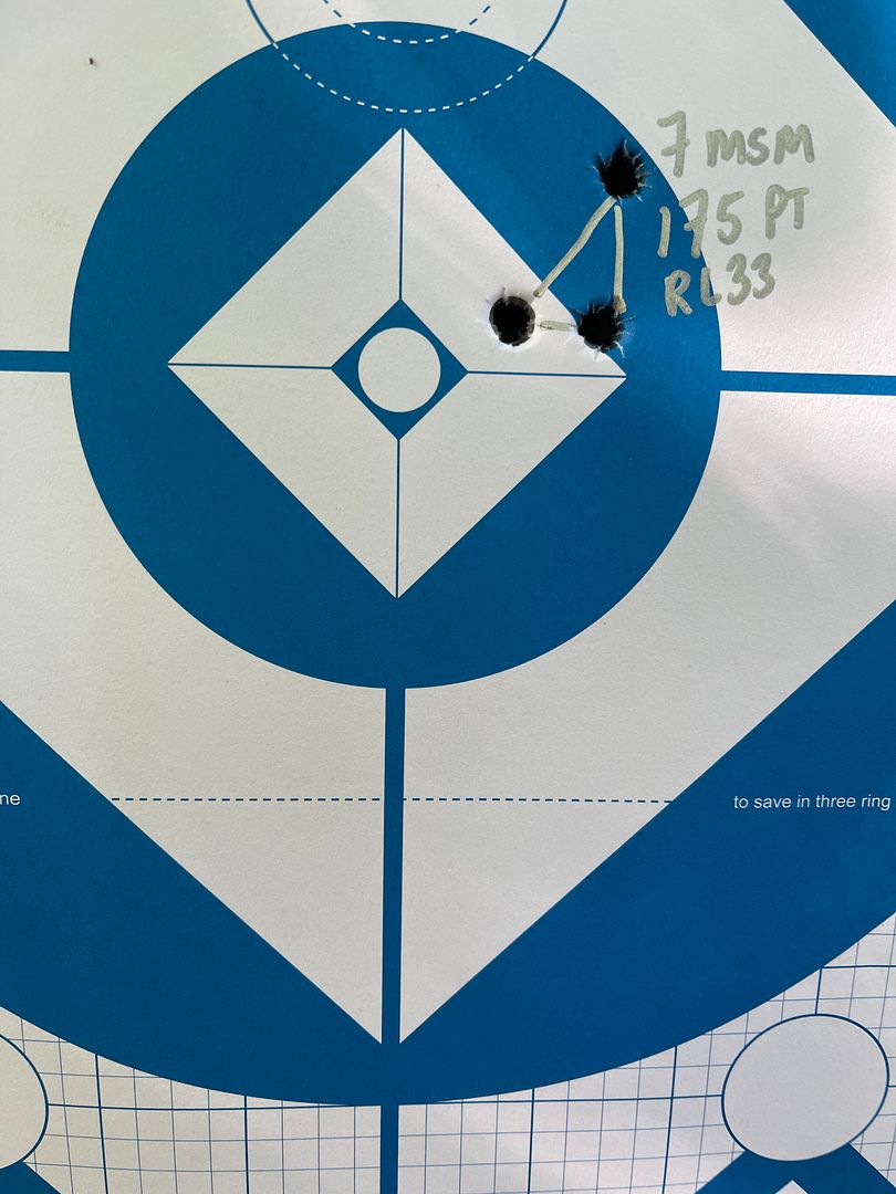

So I decided to zero it with some old ammo I had with 175 PTs and RL33. I shortened them some so they weren’t jamming and was pretty happy for the first group out of the gun.

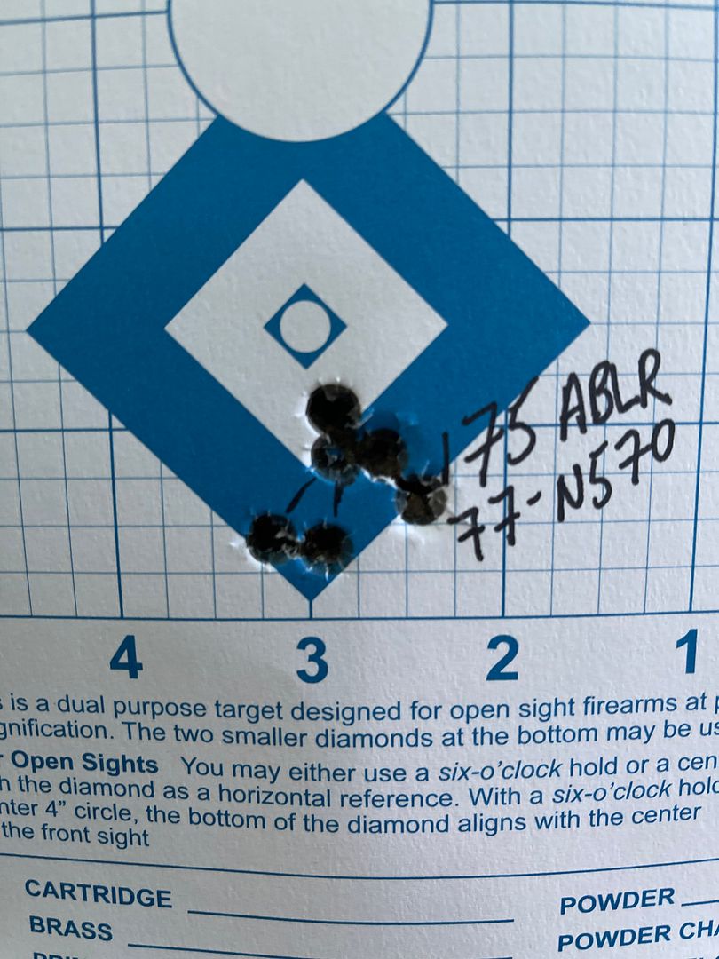

Once I had it zeroed close enough I decided to try some VV N570 and 175 ABLRs. I seated them so they were about 70 off the lands and did a quick load work up.
With 77 grains looking pretty decent I loaded up three and let em fly.

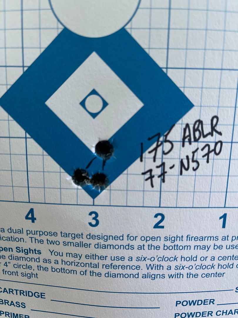

I was quite happy with that. Butttttt I’ve been tricked so many times by ABLRs I decided to put three more on top to see if they held up.
Now I was very happy. It’s a fairly light rifle with a decent amount of recoil but man, I am ready to get this one out long.

Sweet rifle Scotty. You have it set up as a long range hammer that shoots flat as road kill.
sure looks like a winner .
edit to add ;
I never weighed mine all in . I hung it on my lyman trigger gauge. with the scope , 8 pound 13 oz . 25" bbl , .630 muzzle dia , edge stock . I'll guess my extra weight is in the scope rail
8 and 3/4’s ain’t too bad either. This rifle was up over 9 with a 3x9 SS on top and to me, my brain says that’s too heavy for a 7 mag.

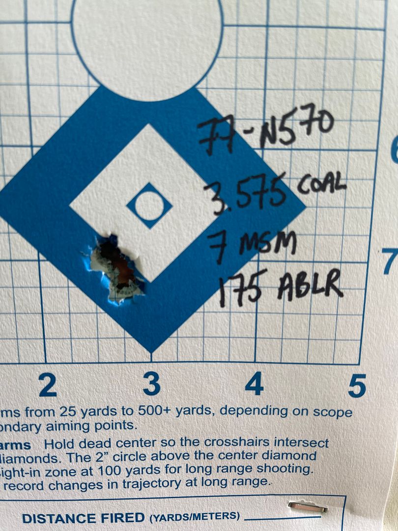

I shortened up my load another 25 thousand for a total of .100.
I tried to shoot 3 more on top, but sometimes I should leave well enough alone :lol:
I also ran some BBCs through the gun at a 1/2 grain less in order to match the ABLR speed.
I ran a ABLR in to that group.
Okay! Now I think I’m done messing with it :mrgreen:
