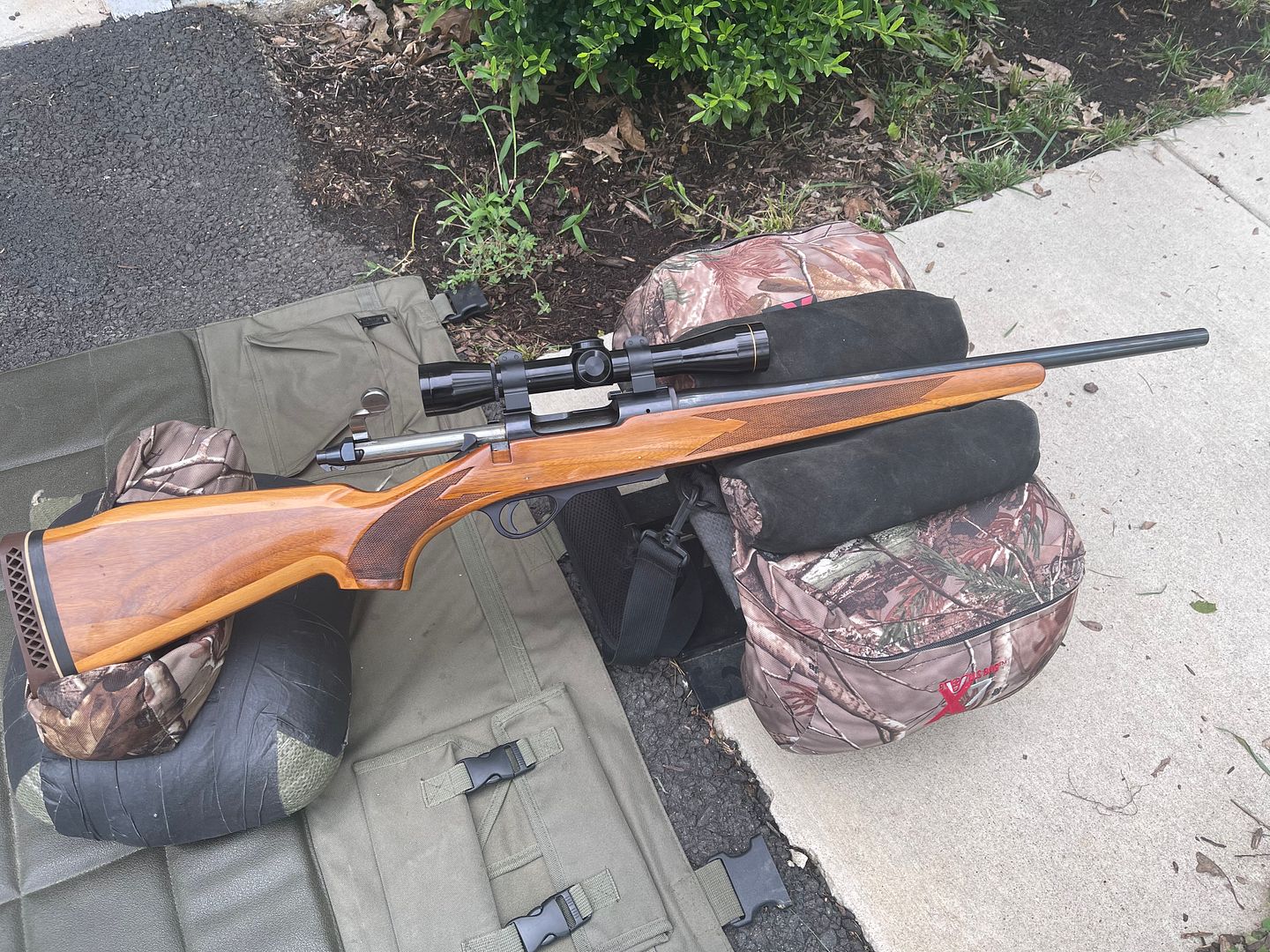

Got this one earlier this week. Has less than a box through her. Accurized and customized through Hill Country rifles, ceracoated, custom bottom metal etc etc.. Anyway I could not pass it up.

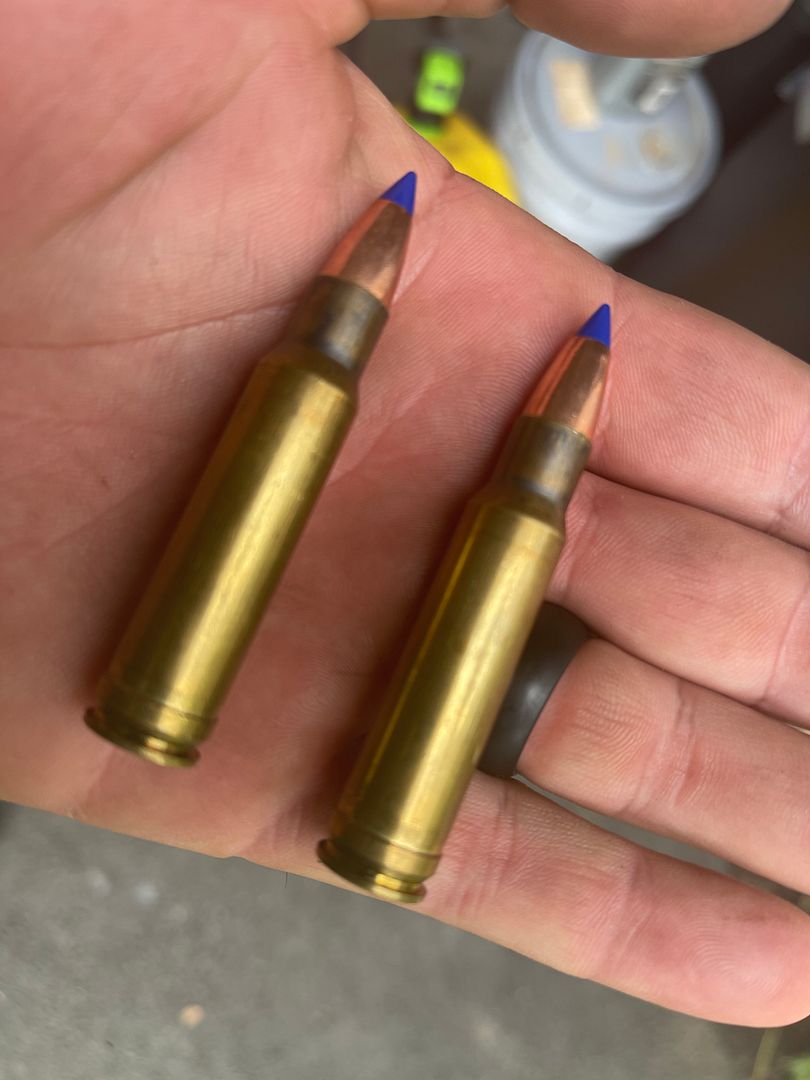

This is the best load I had today. Theoretically this is one grain under max ..... max being 64 grains of tac. Velocity is way up there and I can tell you it is absolutely maximum load. It did show some slight ejector mark but she scooting.
All else being equal I wish you was a hundred feet per second less with the same accuracy I just don't like being close to Max

Thank you fellas 1 grain less dropped 30 fps or so but group opened up to 1.2"
Those ejector marks....not sure I can live with that. Have to try new loads this coming weekend.

I don't think I can roll with that load. I am way too anal. I can not live with the ejector marks. That is telling me danger zone. Not good for the rifle, brass or me. Hopefully I can hit another node in the 59.5 to 61.5 of TAC. If not Win 748 and H4895 are next.

I’m betting that you could play with the seating depth and get some if not all of that accuracy back.
Nope you can not. The plague of the 350 rem mag. Longish 358 cal bullets and a very limiting 2.8" to maybe 2.81" COAL. You seat it there like it or not and it is what it is. Now if it were my whelan............
I understand not being able to seat it out further but can you not seat it shorter, or is the ogive the problem there.
