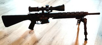

My 270 AR and 270 MSR are both on AR15 polymer lowers with Geissele SSA-E triggers, 45 deg safeties, and MagPul BAD levers.
Lately I've been switching to Vihtavuori powders. I use N135 in the two AR's. I was using IMR 8208 XBR and Ramshot Big Game.
In the 6.5 CM, 260 AI, and 270-08 I have just switched to N555 from H4350 and Reloader 16. Before anyone says anything derogatory about barrel life with double base N5xx powders, N555 isn't your daddy's double base powder. It is specifically formulated to be lower energy than the other N5xx powders with a combustion temp more in line with the N1xx single base powders. It is specificaly designed to give long barrel life in 6.5 CM and similar cartridges.
