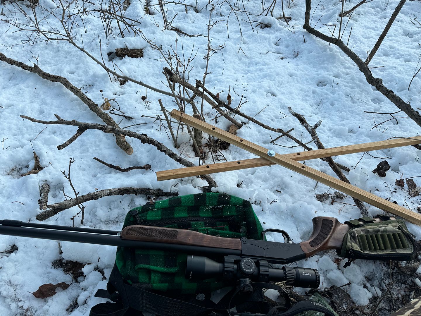

Still trying to sort out the optics on the rifle as the initial set up had the darned scope way too high for great shooting, but I am figuring this out as I go.

I shoot the 50 cal Savage 72 GR/ RL7 / MMP sabot / hornady monoflex 250 Gr. .458. Shoots under an inch @ 2,400. How much drop at the comb and heel? Looks like a bit on that rifle.
Not sure. I had to put a stock pack and super low rings on it. They’d be good with a stock more suited to scopes. I think it’ll work though.

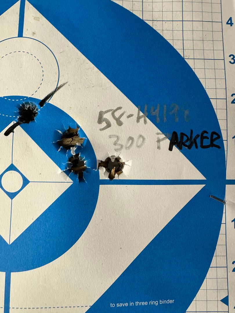

58 grains of H4198

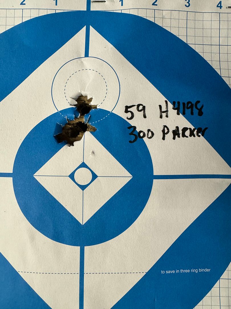

59 grains of H4198

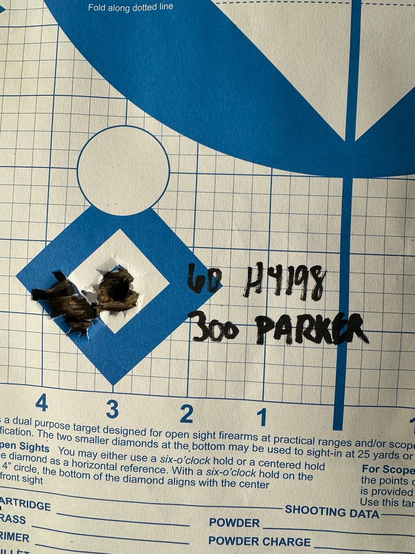

And finally 60 grains of H4198
Seeing as I had a good zero, I loaded my tubes with 60 grains of H4198 and swaged the rest of the Parkers making sure they were spot on at .450.
