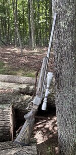

Just got my rifle back from the gunsmith. It came out great. Went with a 26 inch X-caliber varmit barrel, 1:10 twist in 308 and had a Jard 2.5lb trigger installed. Topped it with a Leupold VX II 4x12x50 scope I had in the safe.

Looks great! I bet she's going to be a shooter.
What bullet(s) are you going to run?
I have some 150gr NBT and BSB as well as some 165gr NBT. Should be able to get one of those to shoot. Have lots of powder options on hand.
I've had excellent accuracy with Varget and IMR4064 with those bullet weights in the 308.
