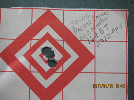

30-06, 60 grains of Ramshot Hunter, 178 gr Hornady = 2860 fps with 3/4" groups from my 24" Rem 700 CDL. That seems to be pretty much a max load.
I actually backed off from that load a tad for hunting, but have taken a muley buck at 350 yards using a 180 grain Berger and the cow elk at 405 yards with Hornady's ELD-X. Hunter is certainly a worthwhile powder for the 30-06 and I like how well it flows through a powder measure too.

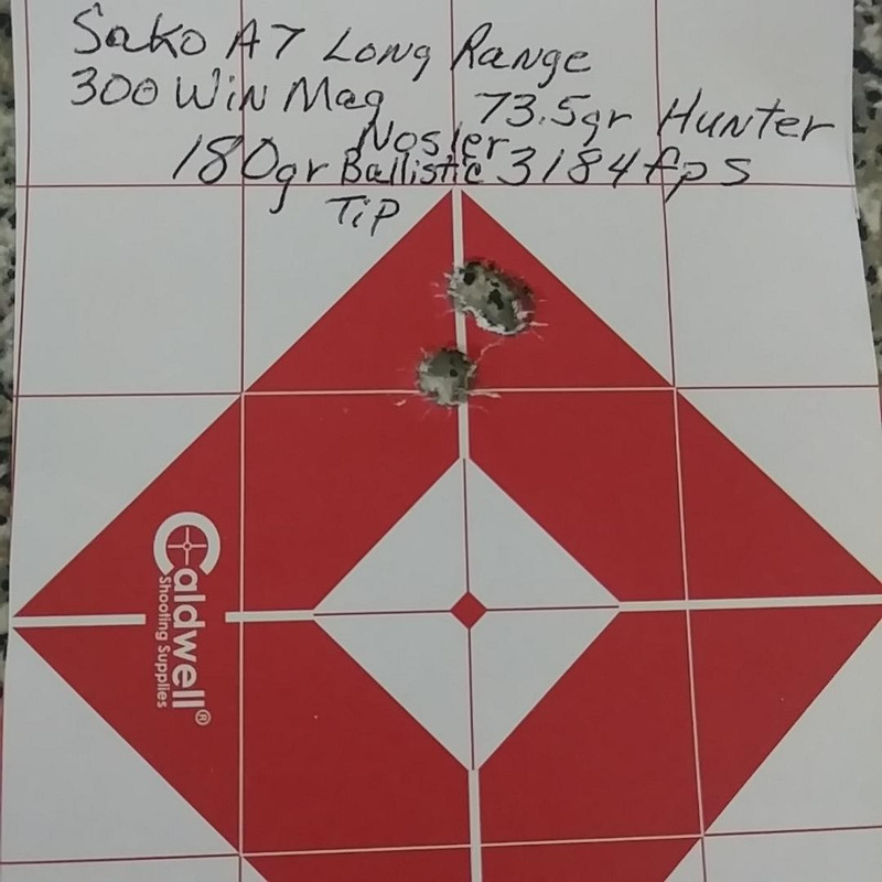

I think people are discovering how good Ramshot powders are.I like Hunter in my 300 Win Mags and 30-06's.It seems to load like IMR4831.
For whatever reason I never grabbed for the RS powders first, until I started looking for a RL-26 replacement and tried Magnum. That really eased the sting of no 26. Launches a 143 hammer at 3150 and .325” groups from a 280 AI with a 22” barrel.
I think it has more to do with the handloader/shooter than the powder. Your targets look simillar, no matter what cartridge or powder you use. Great shooting by the way
