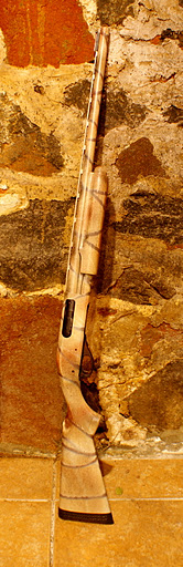

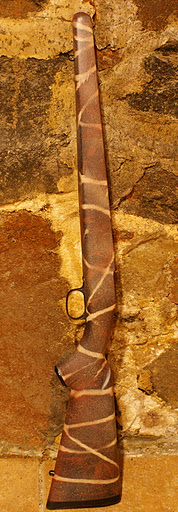

Songdog":19lx4qmi said:dubyam":19lx4qmi said:Out of curiosity, how are you guys (Songdog & Deertracker) getting the grass blade effect in your camo painting?
Here you go... a photo demo....
First I lay down a base coat.... just like in the above picture (in this case, Sage Green Krylon)
Then, I get a small clump of grass (either real or synthetic) and lay it across the stock
When I paint over the grass (with Dark Green Krylon in this case), I try to hold the can a little further away and move quickly across the area... that way the lines aren't as "hard" and it gives a little more depth to the camo.
I then go back over the top with either another color (in this case Khaki Krylon) and move the grass around at different angles, or with a light misting coat of the original base color. This obscures this lines a little more, and creates the shadow/multi-color pattern.
It's actually pretty easy and takes less than an hour.... If you want to send me your stock, I'll do it for you...
Thats the same way I did mine. I cant remember which was first but I did either a OD green base or a tan base, then laid needles from a Ponderosa Pine tree on the stock and sprayed over them.
