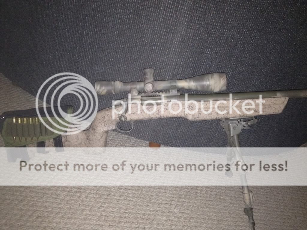

Just got this B&C Tactical Medalist A5 for the 243 AI. It needs to be bedded and floated but still a good stock for the money. My Sendero has an H&S and had to skim bed that one.
