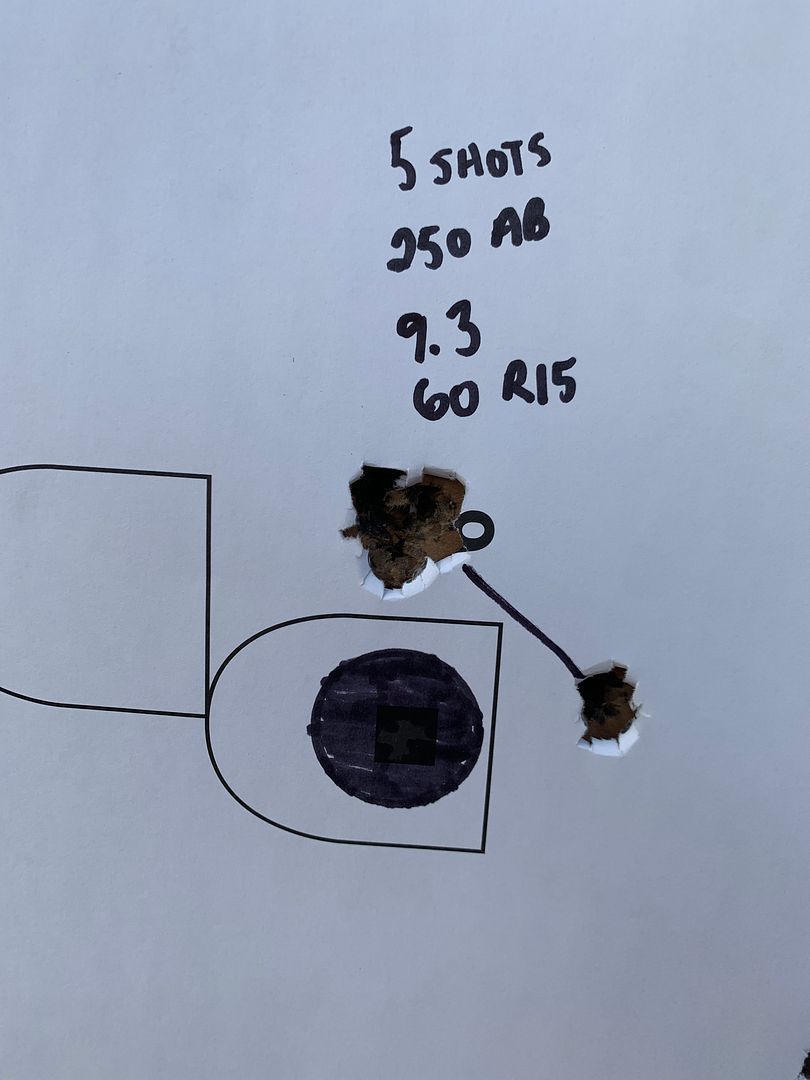

So I had a long action Hawkeye with a McMillan stock in 280 Remington, I kinda had a hankering to try a 9.3x62 so I sent it off to JES to have it rebored/rechambered with a 1-10 twist, 3 groove barrel.
The 9.3 has a million miles of freebore to accommodate the old RN bullets that were used and 250 Accubonds were loaded to fit and funtion in the magazine. Anyhow, I decided to try Barsness load with RL15 and 250 Accubonds.
I loaded up 58, 59, 60 and 61. I didn't get to the 61 grain charge, and 58 and 59 were roughly around 1.25".
Here is 60... I tossed shot number 4 and decided to see if I could redeem myself..
Pretty neat cartridge. No idea on speeds yet, but I'll check them eventually. I am guessing its around 2600 FPS or so though going off of others data.
Nice! With that bullet and accuracy, I don't think I would be concerned with the velocity other than just to know what it is. It's going to be a big game thumper.

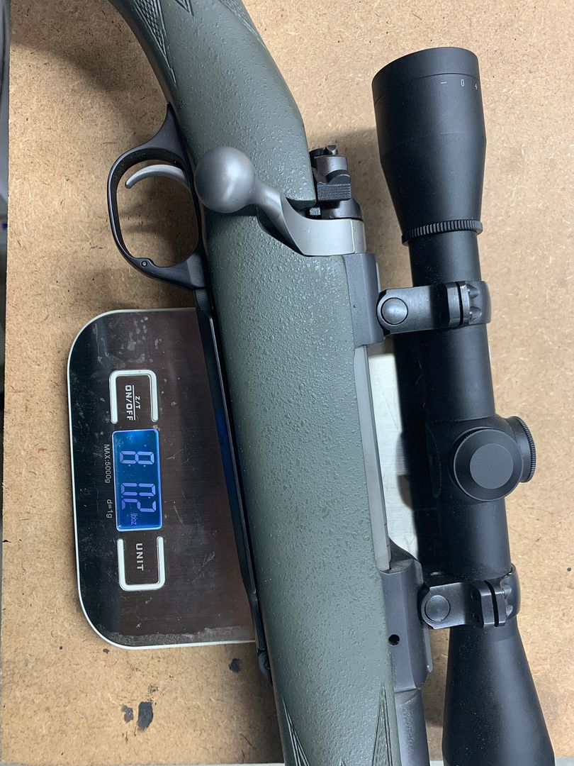

To be honest, I have loved the 35 Whelen for years now and really like the medium sized bore's on the 06 sorta case. They seem to be super accurate. I had a Ruger that I wasn't really in love with as a 280 that I thought was too heavy as a 280, so it was a quick trip to JES and the reduction in the weight from the rebore on top of I don't mind a little more weight for a heavier caliber worked out excellent. It goes 8lbs on the nose as it sits with a 6x36 right now in the McMillan stock.

Well, I just got back to this today. I had loaded the remainder of my unfired cases with the 60 grains of RL15 and decided to have a whirl at distance with the rifle. Looking at the ballistics ap, I kinda guessed I am around 2600 FPS, So with a 225 yard zero on the main crosshair my first dot in the 6x36 would be on at 300 and a couple inches low 400 using the 2nd dot. Well, I forgot my rangefinder so I just laid down at the 200 yard line and starting hammering away.
First group was a little low and left, adjusted the scope and shot the next one. Pretty much on the money with the 6x36. I knew I needed to be about 1.5” high at 200, so I added 4 clicks and moved back to 400.
I didn’t measure it but it’s roughly around 5” I’d guess, but it was about where it was supposed to be. The dots leave a little to be desired shooting paper but their great for hunting so I deal with it.
After I got it where I wanted it I hammered my steel at 400. Talk about fun, I was alternating between my 300 RUM, 7 Mashburn, 30-06 and to be honest it wasn’t any harder to hit with the big 9.3 as it was with any of the others. Pretty darned good shooting rifle for a fairly inexpensive rebore.
I think I’ll run it over the chrono and maybe check and see where I’m at in regards to a node but what I’d use this rifle for it’s entirely elk worthy to 400 yards and I’d have to think it’d pound one.
