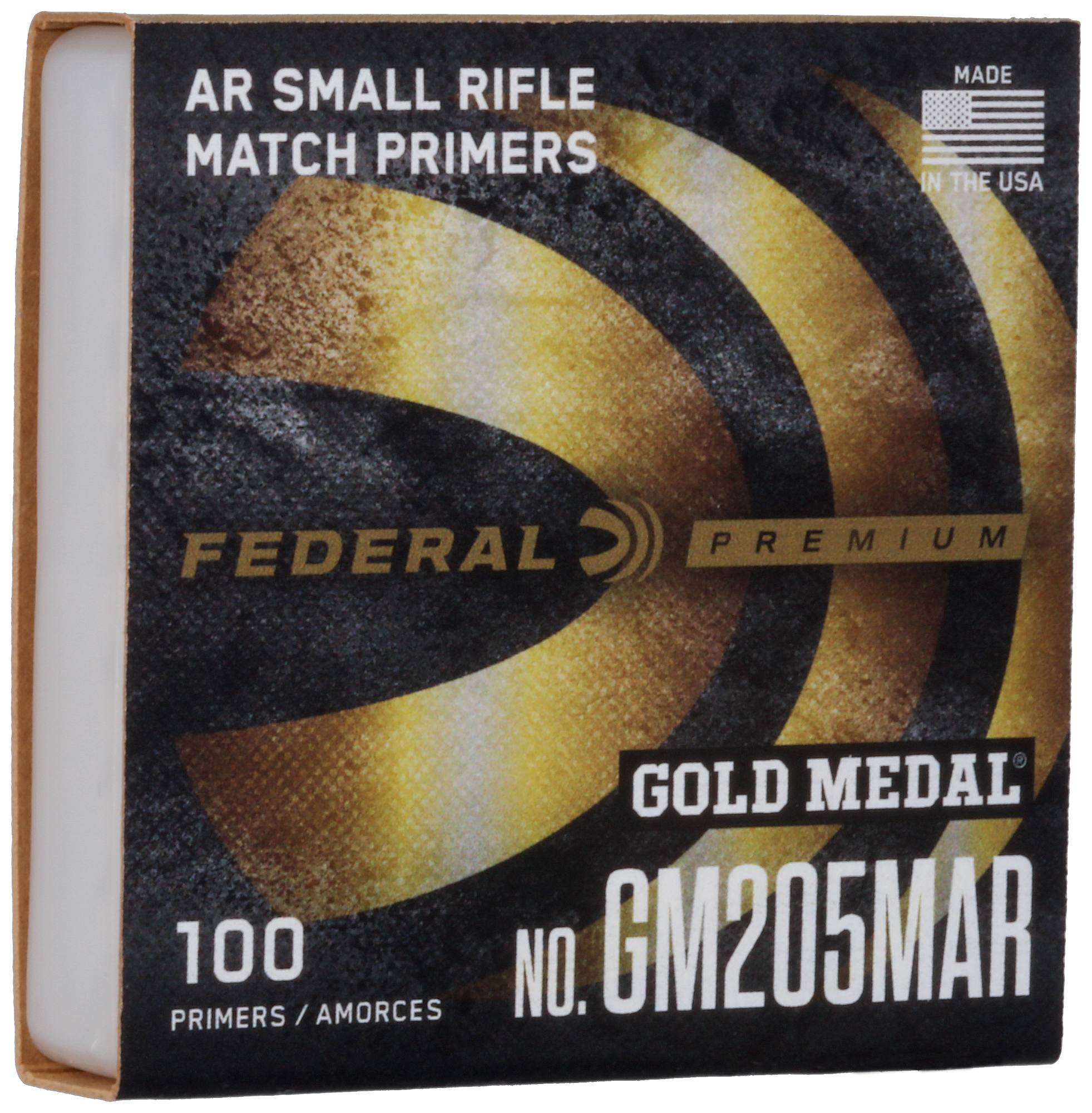

Federal primers are considered to soft for AR type rifles unless you get the AR small rifle primer I have a brick of those and some of those starline brass for my 6.5 but never tried them yet. I did get some pierced primers as well in the large rifle when using the federal match primers. I will switch to CCI going forward except that I will use the AR federal primers when I ever decide to try the small primer cases.

Exactly my thoughts. I ran a pretty hot load thru the 260, no issues, switched the barrel to a 6 Creedmoor and pierced primers, craters and even blown primers. Load was a factory Federal blue box, velocity was all over the place. Started getting wonky cycling issues. Reached out to Slash about his heavy buffer system, cured the popped primers and cycling issues. Spoke to Aero about the firing pin diameter and they wanted me to switch to the AR primers. I called JP and Toolcraft, ordered a nickel Boron BCG from Toolcraft and the standard Nitrided HP BCG from JP. Both worked immediately. I think I measured the pin in the standard BCG and it was .005" longer.
