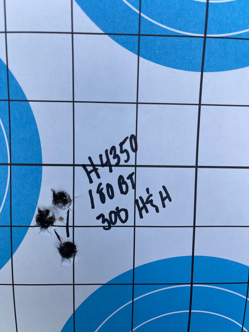

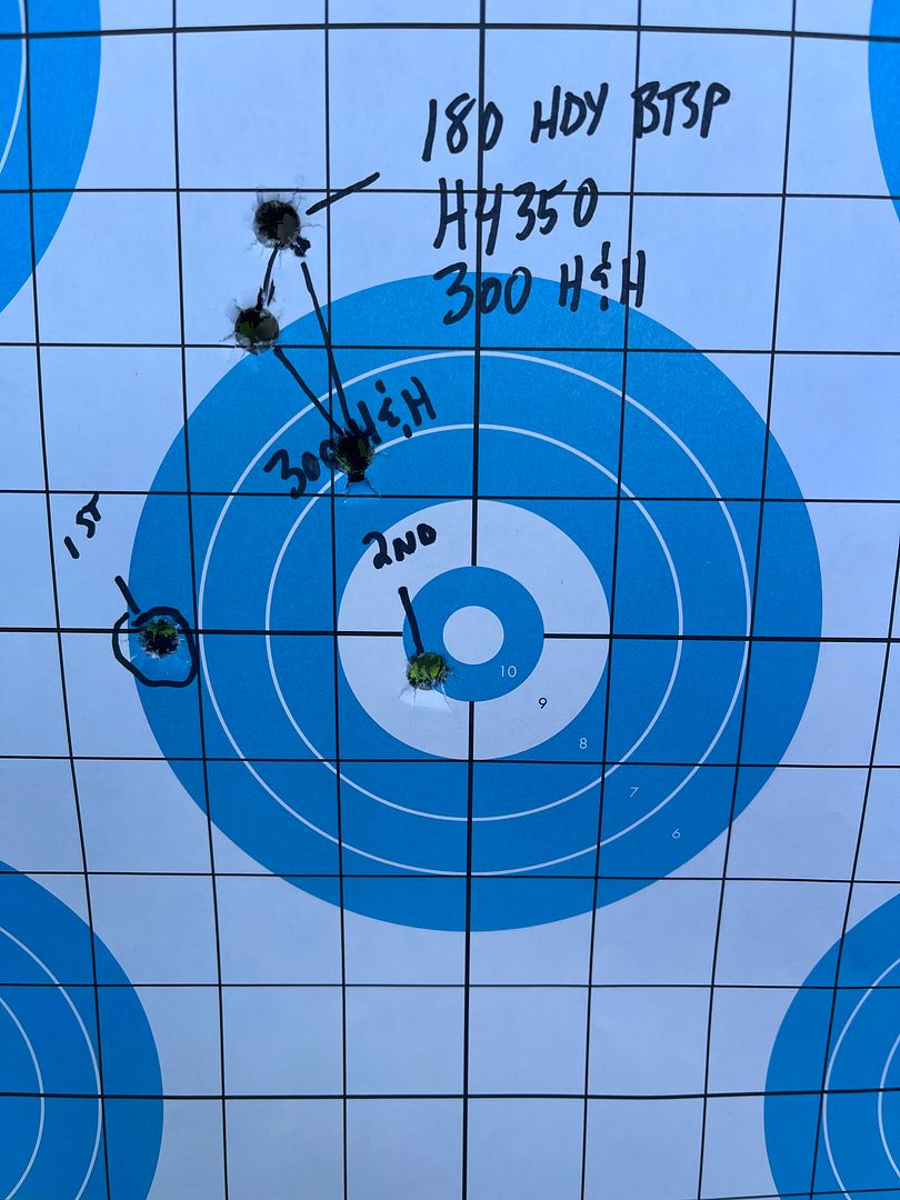

Forgot I'd posted this. Haven't had a ton of range time with it, but I loaded up some 180's I have kicking around with the Accuracy load from the Sierra manual.
The rifle gave me fits. I had it in Warne bases and Leupold Backcountry rings with the Swaro but I could never come close to getting it zeroed. Got the Redfield Jr 1 piece mount off Pre64Win.com and put a 2-8 Leupold I had hidden in my stash on it. Well, low and behold, it started behaving.
I need to get back after it and try the 180 BT's again and see if I can get it to repeat. It is quite the cool old rifle.
