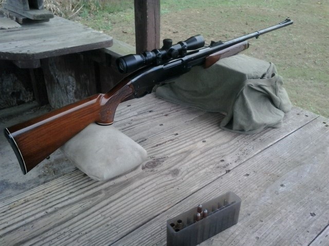

Just an FYI about the scope on this rifle. It's a cheap line of scope. A Konus Pro 1.5-5x32. I dug out my receipt for it and I picked it up new on Ebay last yr for $49. They seem to be running about double that now, but still not an expensive scope.
I got it because the reticles are etched into the glass, making it virtually shock proof. The reviews on it I seen on other online sites were a lot of positives about it holding zero. Seemed a lot of guys used it for a shotgun scope.
Lots of scopes out there. This is one for me, doesn't fall into the junk category at all for the money. Over 4" of eye relief, plenty clear, holds zero. My only complaint is I'd like thicker crosshairs for hunting. If you are looking for a scope in this magnification range and see one of these for under $100, I'd say try it.
