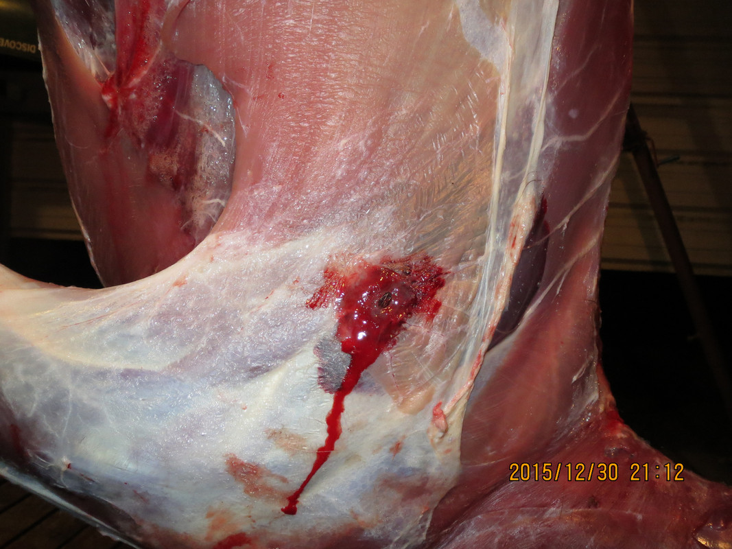

FWIW, last year I used the new 7mm 160 gr BT in my 280AI at 3000 fps to anchor a late season doe in her tracks. Range was about 50 yards and the exit was not excessive.
I forgot that Nosler came out with the 7mm 160 gr. BT. I must not have ever seen any for sale. That would be very interesting combination. :)
