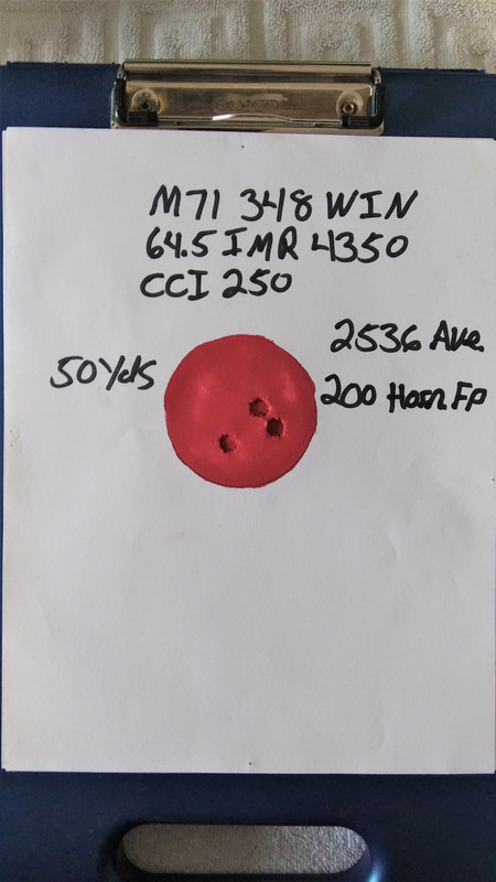

Got an alternative to my Varget load I'm getting low on, in 348 using IMR 4350, and didn't waste a bunch of bullets finding it.
Initially loaded 2 a grain apart just to check speed and based on what I seen being plenty low I loaded the next one 2 grains higher to be able to check speed only when I went to test. Loaded 3 a full grain above that figuring I would still be fine on speed, then 3 more a 1/2 grain above that. So 9 total.
64.5 grains gave me 2536 average with a 10fps E.S. Should still be low pressure with that slower powder. I hit 2600 when testing with Varget with no issues.
Group measured .820 at 50 yds. Might of got last shot itis trying to get the last one in to see what it could do. Regardless, it probably shoots better than I can most days with iron sights.
I have it in my head that Big Game would be a good powder with mag primers and these 200 FP's. It sits halfway between Varget and IMR 4350 on the burn scale. If I come up with a can I might try that yet.
Great shooting ST. That's a good hunting load.
Was your charge compressed at all? I wouldn't see any issue with getting a bit more if you wanted it with 4350 if Varget did it so easy..

I'd say that's pretty darn good for iron sights at 50 yds with a new recipe.

Yeah I got some room yet....sits just under the neck base. Got a little jingle when I shake it. I'd say I got room for 1/2 to a full grain yet before being against the bullet or very lightly compressed. Maybe even 1.5 grains if speeds would allow it.
If I can pick up another can of Varget reasonable along the way, I might stick with that load. Runs about the same speed. Usually hangs right at an inch at 50, and does it with 56.5 grains of powder, so a little easier on the backend of the thump. But if I can't it's nice to know I got something I can switch right over to without issue and be ready to roll.
These were shot with new brass so I'd have some more room in all likelihood with the fireformed. I set my die for about 2 times to just bump the shoulder a couple thousandth's on fireformed brass even though it's head spacing off the rim. After that I got to hit them with a full length size again or they start to get tight at the base.
