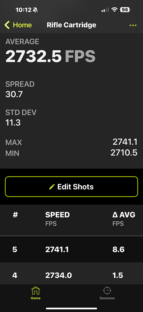

In 24” you can easily reach 2700 FPS with the 225 SP-RP Hornady with RL 17. Suggest WW or Norma brass to do so.
I ended up using reformed Lapua brass but it made 2700 with no sweat using 225 ABs. Haven’t quite figured out the accuracy button yet but it’s coming around.
You are almost there. A little tweaking with the COL and you should be where you want to be.
That would make for a dandy elk load.
