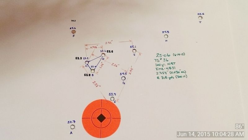

Second trip out to run some ladder tests. I only got 1 set in before the fog got bad enough that I couldn't see the target anymore, but I think I've definitely got something going with the 25-06.
It looks like 53.0 gr. to 53.8 gr. (maybe 54.0 gr.) is gonna be my sweet spot. I haven't run anything across the chrony yet (waiting on a new Magnetospeed I ordered last night), but I don't this load is screaming down range. It seems like the barrel on this rifle runs a little slow. That and I don't have access to my quickload anymore since work took away my laptop and replaced it with a tablet.
The nice little triangle is 53.0, 53.3, & 53.6 gr. measuring 1.14'' at 318 yds.
Yeah, I'd say you found the spot!
What sorta speed is it running in there?

Not sure. I'm waiting on my Magnetospeed and I don't have access to my quickload anymore. Based on other QL's I've ran with 117 gr. SPH & IMR-4831...I'm guessing in the 3200-3250 fps, but like I said, this rifle seems to run a little slow so it's just a guess right now.
A little update. Got the range this morning. I loaded up 3-sets of 100 gr Ballistic Tips with 53.0 gr, 53.3 gr., & 53.6 gr. of IMR-4831 for the 25-06 and shot all groups at 300 meters. 53.0 gr. & 53.3 gr. didn't too bad grouping at 2''-3''. 53.6 gr. was the obvious winner going 0.481''. The velocity was way lower than I expected at just under 3100 fps, but for what I use this rifle for, I'm going to go with this load. I'll retest it tomorrow with a couple of 5-shot groups and run 5-10 rounds over the chrony.
