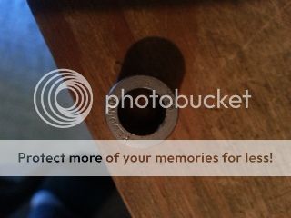

I use 300 SAUM brass. I would really like to find some 7mm SAUM brass, but I can't. It takes two steps to get down to 6.5 from .308. I use these two bushings them neck turn. I'm thinking that I will need to get one more bushing after I get everything once fired and neck turned, but the .295 was pretty dang tight before neck turning. The only hang up that I have had is getting a 6.5 expander inside the 7mm SAUM die. You don't need it after the first forming. So I just borrowed my brothers 6.5 Creedmoor dies and ran the expander down so that it would work. If I could get my hands on some 7mm SAUM brass I could get away with necking down once, but neck turning would still be required I think.
