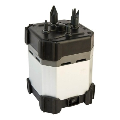

I have an RCBS one, I like it . it gets used every loading session . I keep a VLD inner chamfer , an outer chamfer , primer pocket brush , a bronze brush for cleaning inside the neck . I will put the inside the case primer flash hole debur tool on when prepping new brass with a burr . it's old , and it's been used hard . I'll guess the past year it's developed a clunk , but still seems to be working ok . it's always been a noisy tool . when this quits working I'll buy another prep station , they are well worth the cost . it's a time saver . I pick up a piece of brass , and I do all four , or five stations , then I grab another piece of brass .
this is the one I have . it's a 5 station , I use 4 stations all the time . I use the fifth station when I need to debur the flash hole . I have a separate case trimmer .
