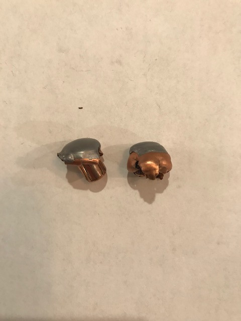

MjMichigan's post about the 180 gr RN and Hornady specs saying it expanded just down to 2400 had me very curious. I did not believe that bullet was near that hard or tough.
Tests came out pretty much as I expected.
First test was at my normal load which will run about 2725 in my 22" barrel. Distance was 20 yds so impact velocity would've been in the neighborhood of 2665.
Didn't hit the jugs quite where I wanted on the first test and the bullet kind of went out the side of the 4'th jug and through the side of the 5'th jug and bounced off the edge of the 6'th jug. Running full width of the jugs I'd say it will for sure be in the 4'th jug, possibly in the 5'th.
Obliterated the first 2 jugs. Bullet peeled all the way back pretty much even with the bottom of the shank. Measured .645 at the widest, and weighed 108 gr's. Would be a whitetail thumper at woods ranges, probably overkill on damage if hitting shoulder.
I then loaded the same bullet with 35.5 gr's of H4895. Estimated muzzle velocity figuring 20 fps loss per inch of barrel with my 22" compared to 24" data, was 1985-2035 FPS. Estimated impact was 1925-1975.
That bullet was in the 6'th jug. Actual lead nose was wider because the faster speed of the 1'st bullet melted most of the lead off the front and the width of the bullet on the faster 1 was the copper shank peels. This measured .575-.600 on average around it, but was in a lopsided fashion underneath. Weighed 143 gr's. So much for only expanding down to 2400.
A comparison of the 2. Normal load of 2725 on right, 2000fps give or take on left.

Looks like a winner to me. You can hunt deer with confidence and never look back. All you need now is a sharp knife.

That looks like a great test. Makes it much more clear in my head. Thanks ST

Shade thanks for your time and effort providing this info. That bullet as you say and proved will be a deer thumper no doubt. Dan.

Good deal. Nice to have all the info. So at that and your starting speeds of roughly 2825 fps, you would be good out to 300 yds as far as expansion. Way farther than I'd figure on using a RN bullet at.
With the minimum of 2400 fps, it would get you out to between 175-200 yds. More in line with what I'd figure as a maximum distance for that bullet. If I'm carrying that bullet it would be in areas where I couldn't ever see to shoot more than 150 yds period, and almost all shots would be well under 100 yds.

MjcMichigan, just another tidbit of information. At the slower MV speed of roughly 2000 fps, the first jug was blown apart with the 1 half laying a full 15 ft directly to the right. The other half to the left was more in smaller pieces. Nothing 100% scientific you can take from that, but to me it means that even at the slower speed the bullet has rapid initial expansion.
As far as a tougher bullet in standard C&C, the Speer HC's and Sierra PH's in 180 are tougher than the Interlock's. Plus the spitzer shape vs the RN slows the initial expansion down. But these bullets would be far better than those 2 would be for whitetail IMO, and would still be adequate for black bear.

Here's 1 more pic just to give a different perspective from a side view so to speak. The 2725 fps bullet is actually pretty impressive. Jacket peeled all the way back even with the base all the way around. Like a domed mushroom covering the stem. I'd say 2650-2850 would be optimal for whitetail depending on how far a typical shot would be.
The really slow impact speed had trouble peeling back the jacket in a uniform fashion, but would obviously still get the job done.
