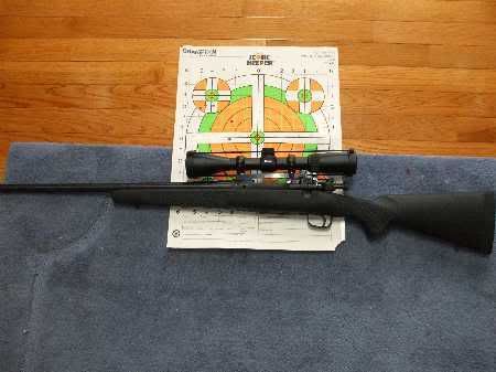

1903 A3 Springfield Receiver/ Douglas Premim Barrel.
B&C stock/ Timney, 3-9X- 40mm Nikon Buckmaster,
Burris rings and inserts. Posted before here.
Thanks for quick reply.. :grin:

You have a nice setup. I hope you try the powders above and use 210 Fed primers with these powders and the 165gr and see what happens. Good luck
