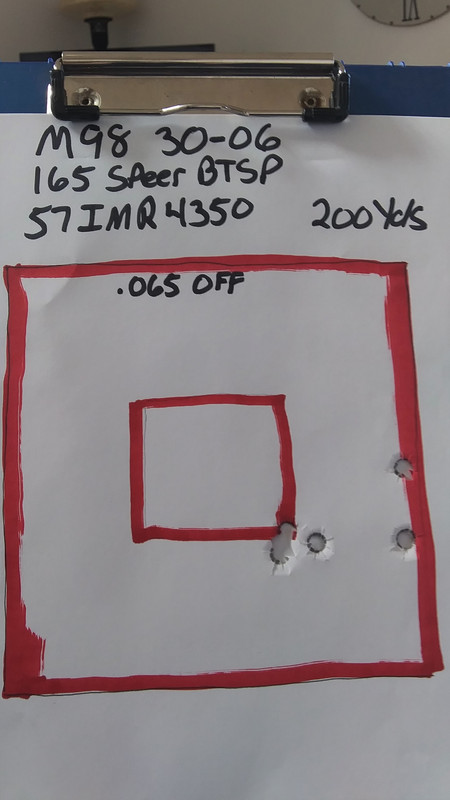

Old M98 I got in 30-06. Stock had a minor crack in it, it's still at my one buddies getting fixed. Meantime couple yrs back I picked up a cheap synthetic stock for it off a table. Stiffened the forearm by using aluminum c-channel from I believe an old TV mounting bracket, cut them to length spread out about 2-3" apart down the forearm and poured it level with 2 part epoxy. It wasn't inletted proper and the action and barrel ran uphill. Ended up hogging it out and bedding it 3 times to get it to suit me, but that's another story. I could've left it alone after I bedded it the first time.
Been running this load through it testing and it has been I guess you would say strong average, but amazingly consistent. I shot 2 different 5 shot groups and a 4 shot group at 200 yards. 2 of the 3 were right on or just under 2", this 5 shot group today was just over at 2.182. All of the groups had tight vertical spreads, 2 groups just had a 1/2" vertical, all the group sizes were from horizontal spread. Today's group had 1 shot high that made it a 1" vertical spread.
I'd say I can count on it shooting a 2" horizontal group at 200 yards at this loading. Might try some at .010 shorter, and some at .020 shorter, just to see if it will get down to around 3/4" MOA at 200.

Some of those old dogs still have a lot of fine groups left in them. Looks as if you have one that isn't ready to give up the ghost just yet.
Yep. Holding an inch at 100 isn't bad, holding 1 MOA at 200 is better. Maybe with some seating adjustment it can do noticeably better yet, or maybe not. It had been sitting a while mostly because I knew I needed to bed it again to be right, and was just shooting other stuff. Got to it last weekend.......guess what those mounts and that Leupold 3-9 came off of? :D

Don't know if I'll even be carrying this rifle this yr at all. Just gives me something to work on and learn more from which is never a bad thing. Was anxious to try it at shorter lengths yet but it was windy today so no go. Bad day for testing
