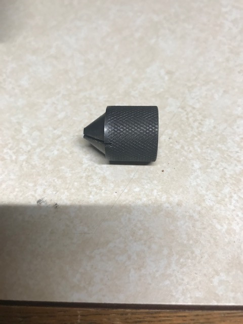

I took a couple pics of my tools . the outside deburr tool seems to work well . put the neck in , push down , and slightly wobble the case around . keep doing this until the burr is gone .it doesn't have a cutter , just the sharp edge of the slits , to do the cutting . I also took a pic , to show the difference between inside deburr tools . the blunt one is the standard tool . the long slow taper one is a VLD tool . I much prefer the VLD tool .
